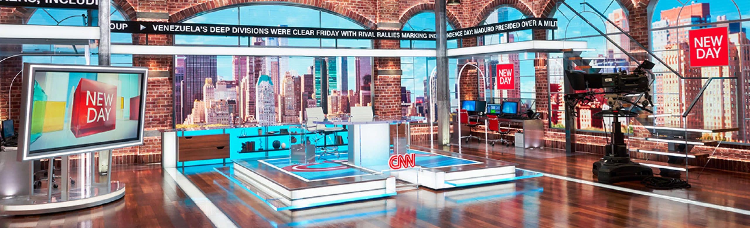

CNN relies on 6,000 square feet of video wall display based on Leyard LED cubes in its four Hudson Yards studios as the backdrop for its shows. Used to display news graphics, animations, cityscape scenery, beauty shots and virtual video monitors for remote guests, the walls help the network better connect with viewers.
“Our audience has come to expect bigger and better always, as well as motion,” says Shawn Mckeever, senior systems engineer with CNN’s Broadcast IT Advanced Systems Group. “The days of the static studio are gone. Movement and text in the wall keep viewers engaged and overall present a better product.”
Content for the LED videowalls as well as LCD monitors in six Flash Studios is controlled via a massive Vizrt Viz Multiplay deployment.
Each of the five studios relies on up to eight Viz Engines— four of which serve as backups—to feed the walls under the control of Viz Multiplay. Further, each engine produces four 4K signals, which are split into 16 HD signals assigned to different areas of the walls. Additional Viz Engines are used for preview, explains Pocali.
