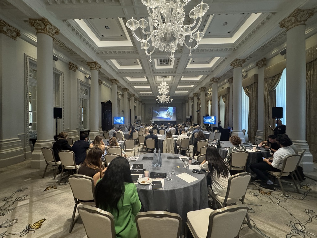

The InMode IGNITE Masterclass brings together leading plastic surgeons to explore advanced techniques using InMode’s IgniteRF and QuantumRF technology. For 2026, InMode wanted to go beyond one-way broadcast and create a genuinely interactive experience: surgeons operating at 101 Harley Street, a live audience at the Langham Hotel, and delegates joining remotely, all part of the same conversation.
That meant connecting three audiences without compromising picture quality, audio clarity, or timing. Any lag between locations would break the natural flow of conversation and undermine the educational value of the event.

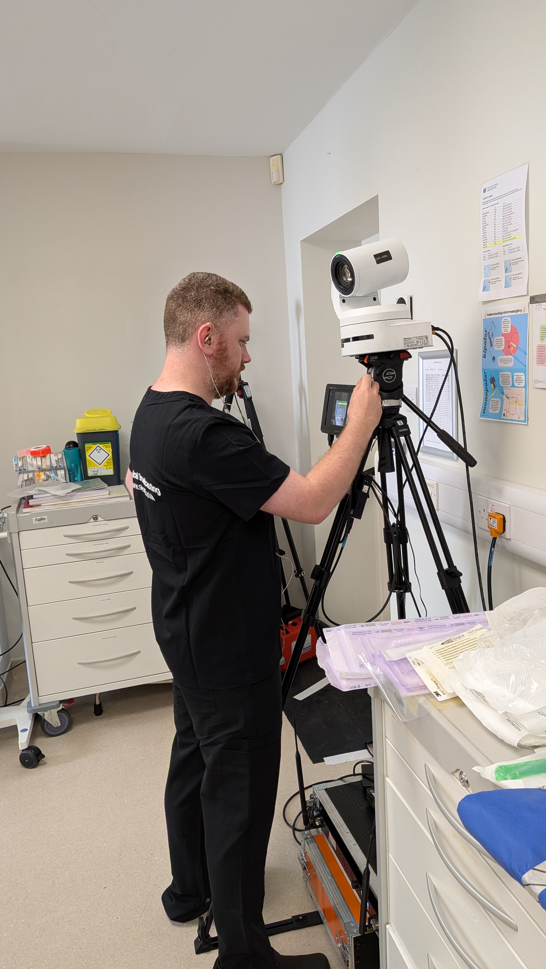

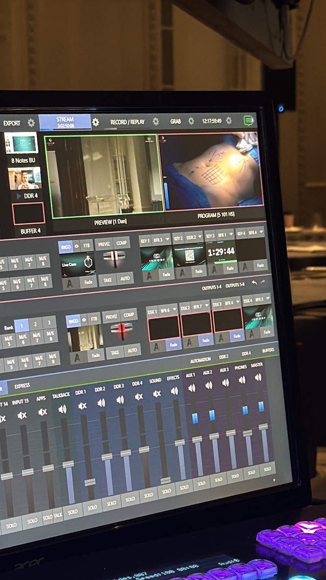

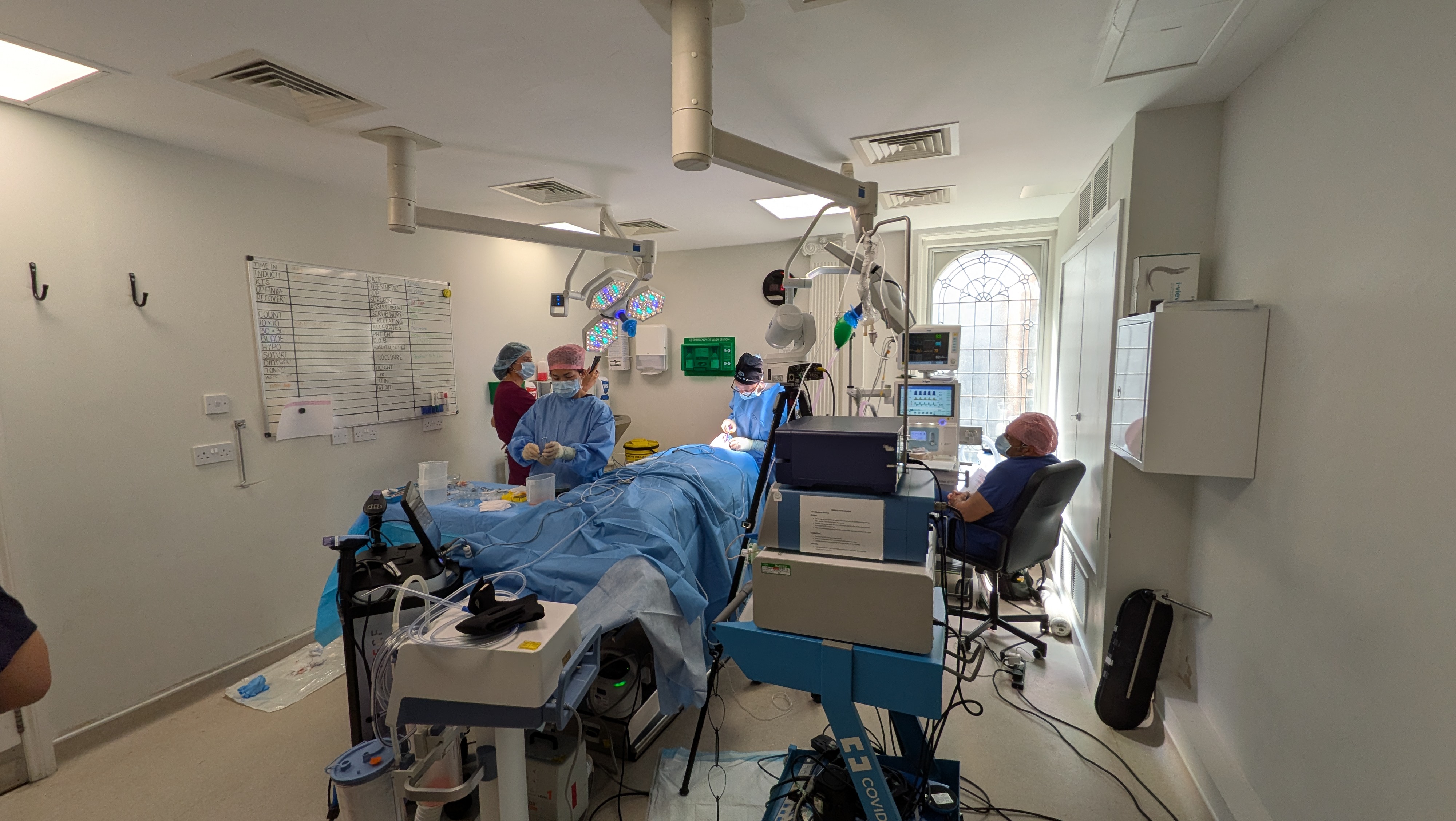

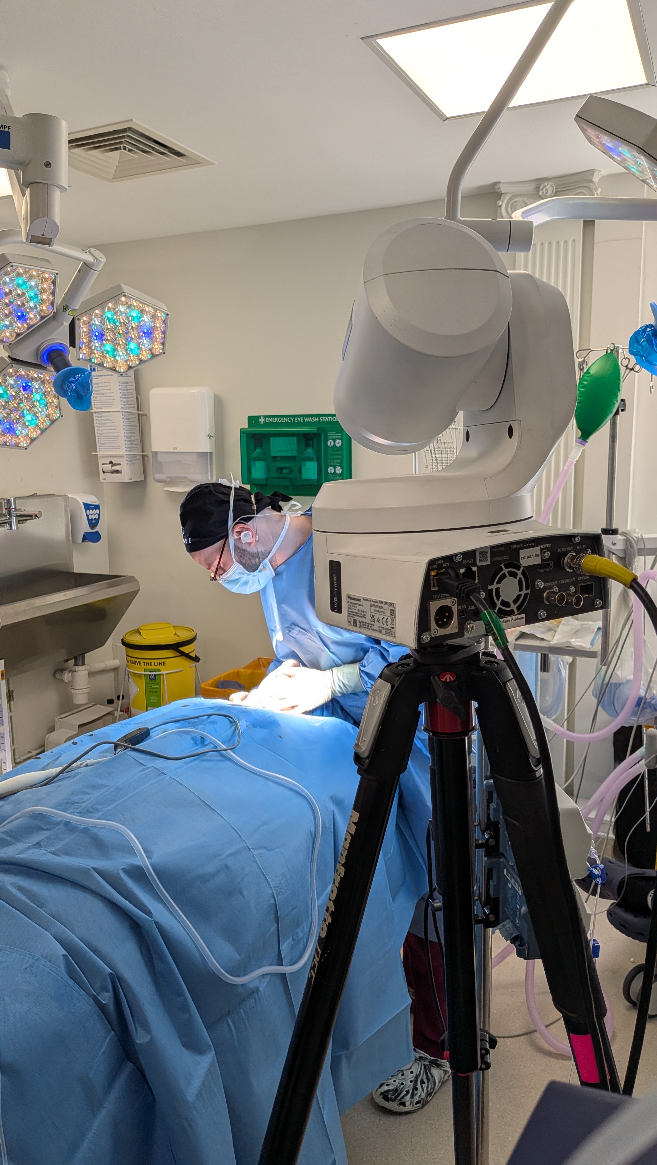

At 101 Harley Street, multiple Panasonic PTZ cameras captured the procedures from carefully chosen angles. A TriCaster® TC1 in the procedure room switched every camera feed and sent it to the conference venue in real time.

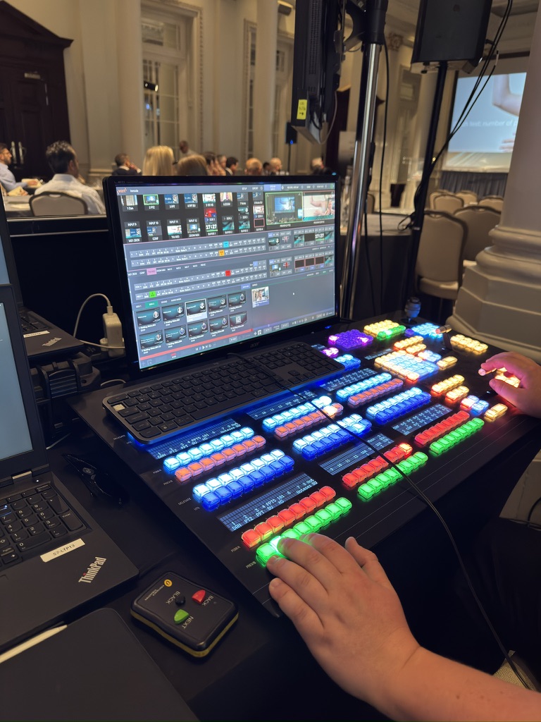

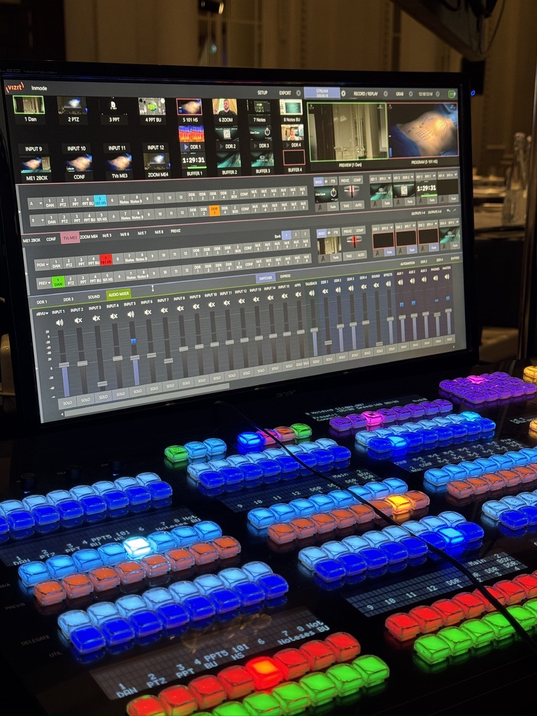

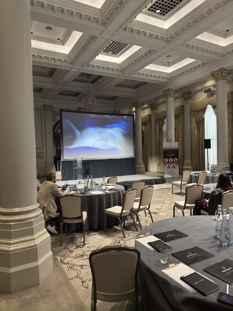

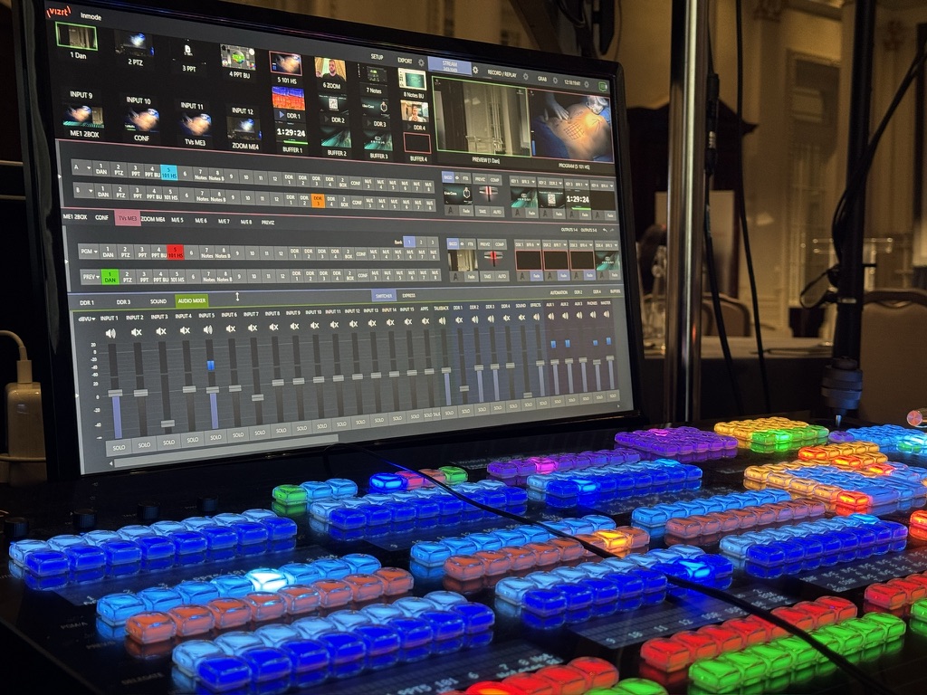

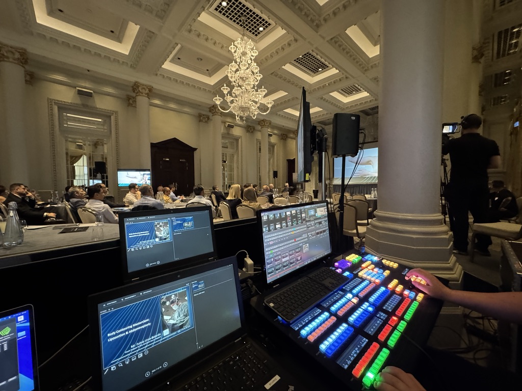

At the Langham Hotel, a second TriCaster® Vizion received the incoming surgical feeds and managed every screen across the venue — projection displays, confidence monitors, and the online stream — while also mixing additional cameras covering presenters and panel discussions.
The result: one connected broadcast, produced live across two sites, with NDI Bridge carrying the signal between them and Vizrt’s TriCaster® shaping it into a polished, broadcast-grade program at each end.

Surgeons in theatre wore discreet earpieces, hearing questions from the conference floor as they operated. Delegates at the Langham Hotel could see and hear every stage of each procedure and get answers as they happened. Online delegates joined the conversation through Slido, with questions folded naturally into the discussion.
