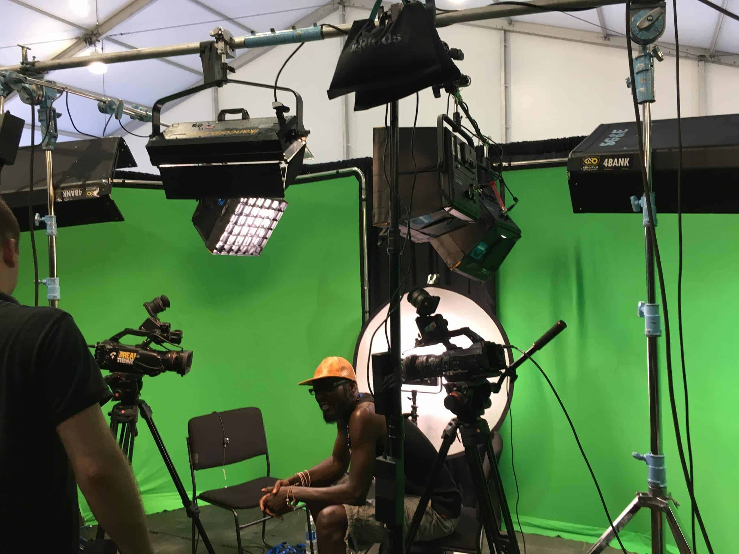

Luckily enough, they did receive credentials and were given a small space in the media pavilion to use as they’d like. DeMillo says many other small news outlets used the spaces they were given as offices, but he and TRNN CEO and Senior Editor, Paul Jay, had another idea. They chose to create a full studio where they could host professional live and recorded interviews with multiple guests.
Pop-up green screen studio in a tent with cameras and lights set up for convention coverage
TRNN’s allotted space at the DNC was used to build a green screen studio on the fly.
Setting Up a Temporary Studio
Prior to leaving for the DNC, DeMillo had some idea of what equipment they would need in order to create an impromptu studio, if they were given the opportunity to do so.
Once they arrived and found out that they had space to work with, DeMillo and five studio technicians built their small studio around the NewTek TriCaster Mini and several Mac mini computers.
With four inputs, the TriCaster supported two Sony PMW-300 cameras on one input, an HDMI external switcher connected two inputs to field cameras, while the fourth input was used with an external switcher to switch between the Mac mini units that streamed TV feeds from C-SPAN. They used Teradek Bonds and Cubes to encode and decode live footage and MD-HX decimators HDMI/SDI cross convertors.
“We essentially turned a four-input machine into eight inputs, which was exactly what we needed,” DeMillo said.

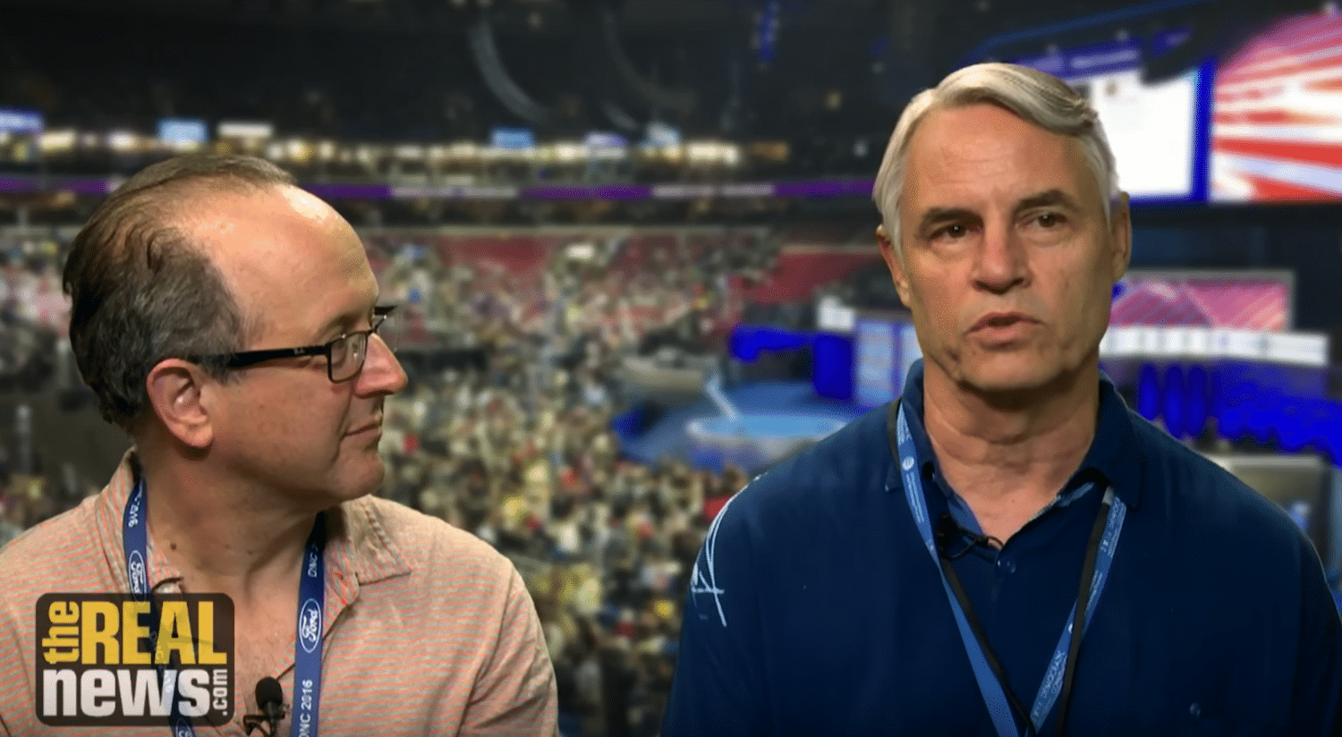

They used Kino Flo Diva lighting, Cool-Lux LED lighting and two Lastolite, three-panel collapsible green screens, which allowed them to create a professional appearance and backdrop behind the host and guests. They used an image of the convention floor as the backdrop behind guests making it appear as though they were sitting directly above it, rather than in the media pavilion.
“The green screens were really a last minute idea and I’m so glad we had them and were able to use them,” DeMillo said.
Two The Real News reporters interviewing on the convention floor with the crowd behind them
TRNN guests appeared against a backdrop of the convention floor composited over their green screen.
