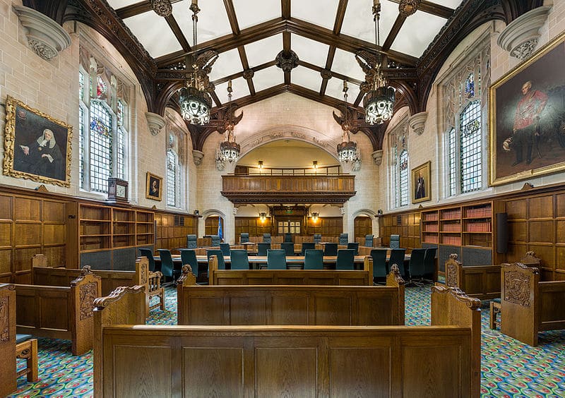

The main courtroom at the United Kingdom Supreme Court where a Brexit case reaching 4.8 million viewers was heard. Note the Panasonic PTZ cameras located in the upper corners of the room

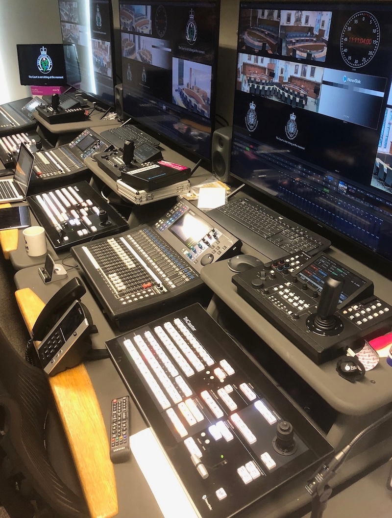

UK Supreme Court control desk with switcher panels, robotic camera controllers and monitors
The United Kingdom Supreme Court uses 3 TriCaster TC1’s located in this confined space. Shown here are the control surfaces and video displays for each courtroom. One TC1 per courtroom.

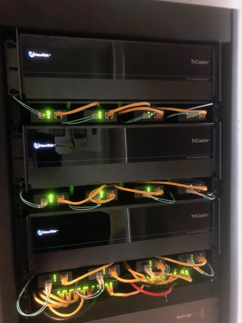

Rack of TriCaster units with network cabling in the court broadcast system
Three TriCaster TC1’s connected to cameras via NDI in each courtroom. Minimal space and cabling required, every two TC1’s act as backups to the other one. NDI drastically reduces the amount of cabling required using the building’s local area network to transmit video signals.

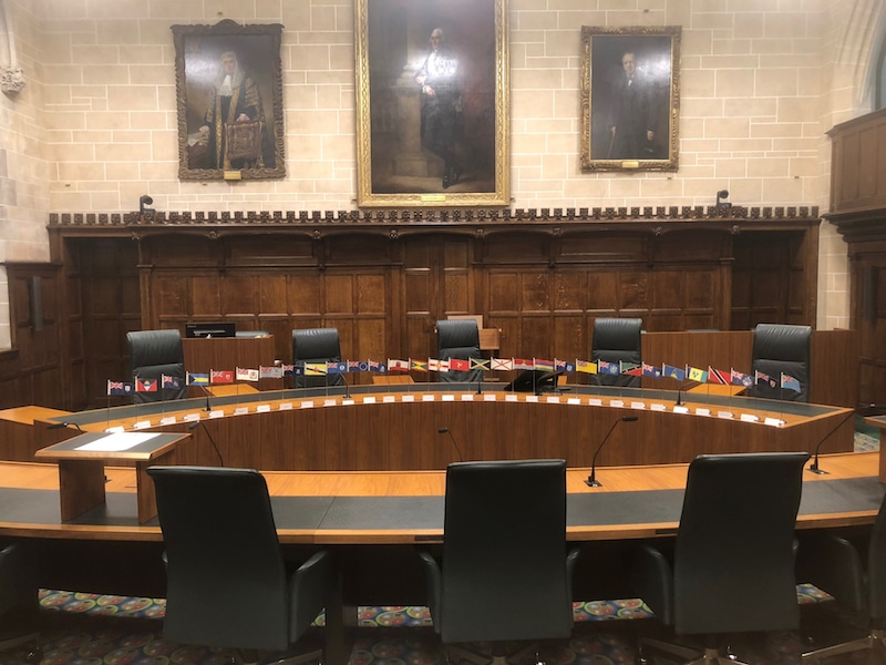

Wood-panelled UK Supreme Court courtroom with a curved bench and portraits on the wall
One of three courtroom’s inside the United Kingdom Supreme Court in London. This courtroom hears cases from other countries within the Commonwealth. Note the Panasonic PTZ cameras above. These cameras are controlled from the main control room where the TriCaster TC1’s are located.

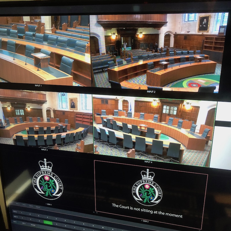

Multiview monitor showing four camera angles of empty Supreme Court courtrooms
TriCaster TC1’s user interface showing the various camera angles in one of the UK Supreme Court’s three courtrooms. Panasonic PTZ cameras can be controlled from this position via NDI
